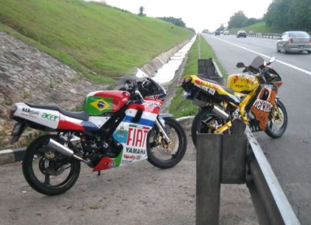

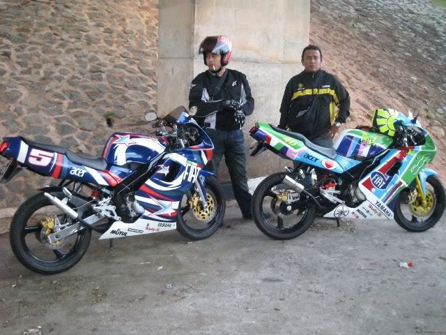

Post by abe_LuiNg on Wed Jun 09, 2010 7:31 pm
kat jb area jalan susur..
ctu bnyk port bt airbrush..mmg cun..
ni antaranya..

moto2 tu wat airbrush rege bape luing?
